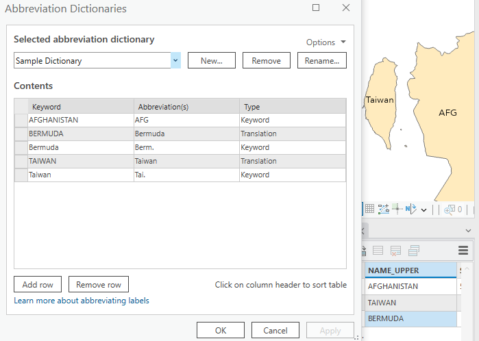

Translation entry in an abbreviation dictionary always changes the matched word or phrase to the new value. But you can have another abbreviation dictionary entry for the translated word. So in this case you might have a Translation entry that changes TAIWAN to Taiwan, and another Keyword dictionary entry that changes Taiwan to Tai. if there isn't enough space.
In the screenshot below you can see an abbreviation dictionary that has 1 Keyword entry for AFGHANISTAN that will change it to AFG only if needed. Then BERMUDA and TAIWAN each have 2 entries - one Translation and one Keyword. The translation entry will always kick in, and if there is not enough space for the translated word then the Keyword translation will be used. (Pardon the geographic impossibilities of this map.)
Here you can see from the attribute table that the data contains all upper case names. TAIWAN is translated to Taiwan because there is room, and AFGHANISTAN is abbreviated to AFG because there isn't enough room for the full word.
Zooming out more and shifting the coverage area shows that TAIWAN now uses the Keyword translation and AFGHANISTAN doesn't use any translation.

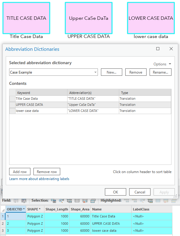

JesseWickizer
If you add entries in an abbreviation dictionary for each country and territory in the case you'd like it displayed at, the label will use the case in the abbreviation dictionary. The abbreviation dictionary entries must use Translation type in order to force each label to use the translation.
In this example, the labels inside the polygon use the abbreviation dictionary, and the labels below the polygon use the original label.
