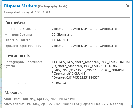

I am using ArcGIS Pro 2.4.0

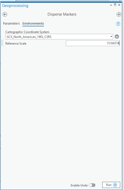

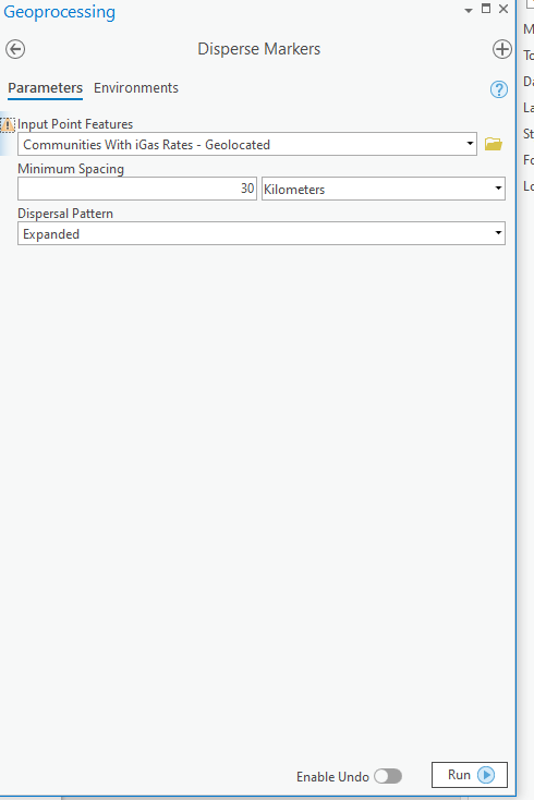

Regardless of the environment and parameter settings I use, when I run the disperse markers tool on my point feature layer, the operation is "completed", and yet there is no change to the display of the points. disperse_markers_details.PNGCoordinate system used is the map's coordinate system. The reference scale used is the denominator of the scale in the bottom left hand corner of my map, for which I would like the points to be scaled to.Coordinate system used is the map's coordinate system. The reference scale used is the denominator of the scale in the bottom left hand corner of my map, for which I would like the points to be scaled to.disperse_markers_paramters.PNG
Am I missing something here?

is that distance spacing appropriate for that scale?  It looks like it should be higher or the scale lower.  Measure 30 km on screen and the point spacing of a cluster of points to see if it is reasonable

I have tried using dramatic numbers (like 500km) for the distance spacing and this also yields no displacement of the points.

I was facing the same issue in a map with a lot of various layers and other stuffs (ArcGIS Pro 3.2). I tried to simplify it by :
1 - Creating a new blank map, adding my layer and setting a graduated color symbology
2 - Turning the Edit mode On (I've set ArcGIS Pro to turn it on/off instead of being automatically on all the time) -> The tool edits the data so I guessed that was something to be done
3 - Running the tool where I set the coordinate system and the ref scale in Environment
And it worked.

Using ArcGIS Pro 3.3.1
This happens occasionally to me, it works multiple times one day, then doesn't the next for no apparent reason (although I am sure there is a hidden/un-noticeable buggy reason.) Came here for answers today and randomly stumbled upon something that worked for me.
How I get it to work is to click on the Edit tab and then click on "discard edits" then retry.  This might hurt if you have made other numerous edits prior, so you might want to instead "Save edits" and try again.
