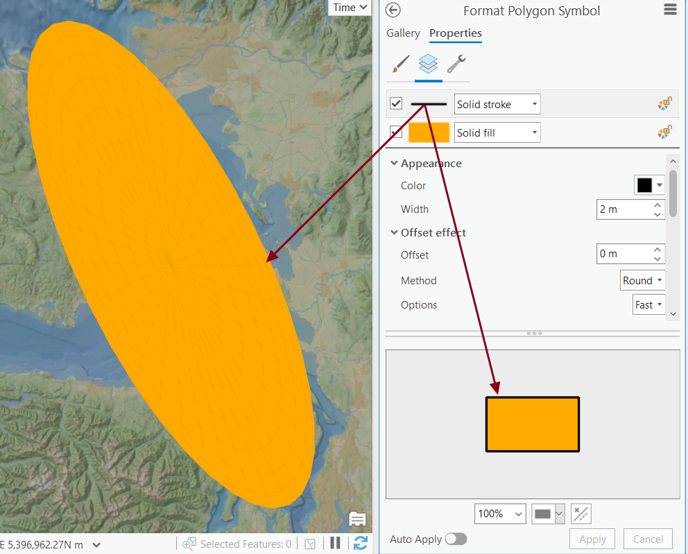

I ran a directional distribution to create a standard deviation ellipse. When adjusting the symbology, the fill color works just fine, but the outline/border won't display. The preview pane in the symbology window shows the border, but the map will not. I've tried moving the layer with the ellipse to the top of my layers with no effect:
Where should I be looking to troubleshoot my border issue? Or is it something that is meant not to have a border?

SeaRM
I think your outline is just too thin than the ellipse is. So the outline isn't visible. Try to define the outline width not in meters, but in pixels. I think it might help.
Jill_Clogston
Ah, great catch @SeaRM! Thank you! Now, need to figure out how to change from meters!

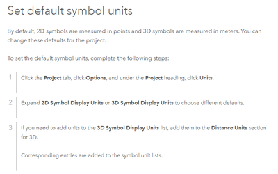

@Jill_Clogston You can try to do it in your project options.
https://pro.arcgis.com/en/pro-app/latest/help/mapping/layer-properties/units-and-symbol-size.htm
But actually I cannot find there pixels, it's my mistake. But you can change your meters to other units by default anyway.

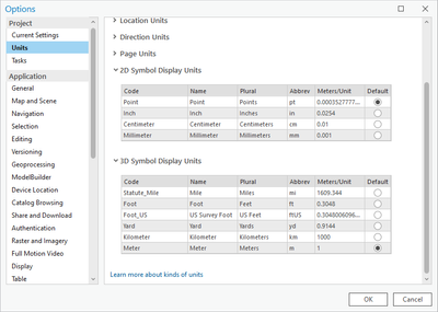

ODWC_GIS
No, you've got it!  Nearly everyone thinks of them as pixels, but they're called "points."  It's a layout term.
You've got Points selected in your 2D Symbol Display Units gui.
