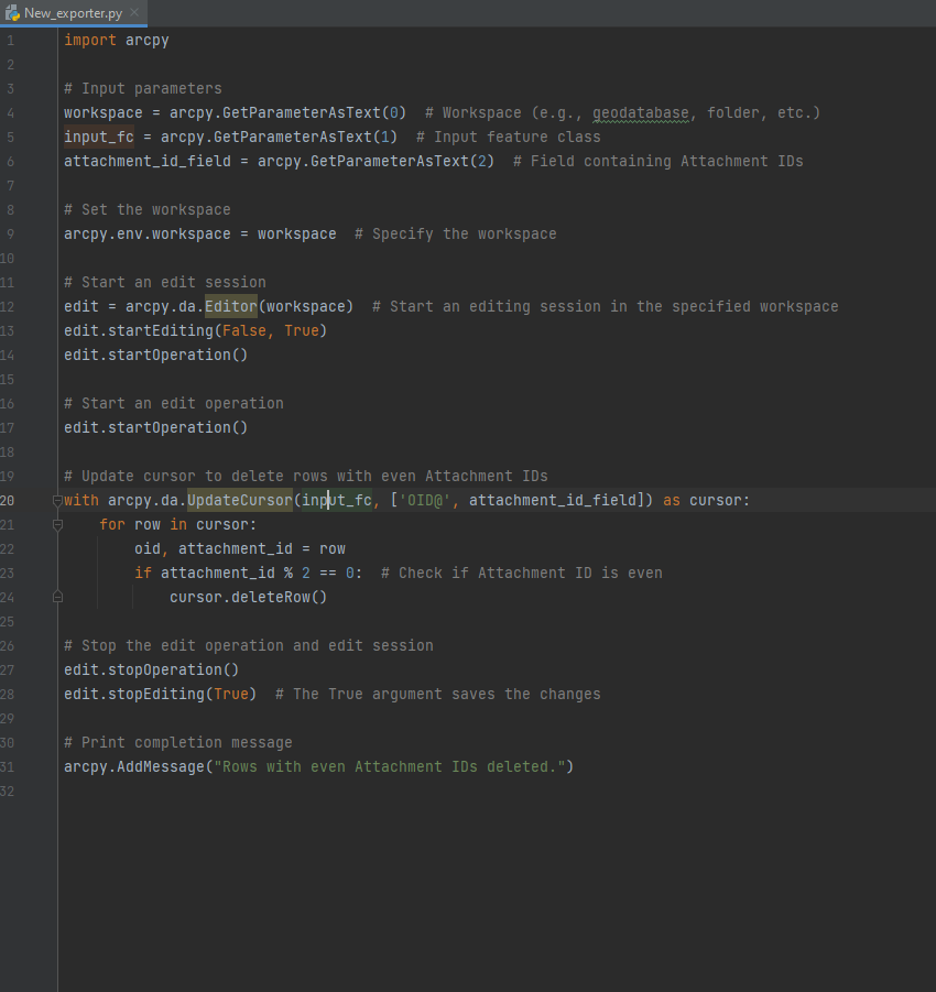

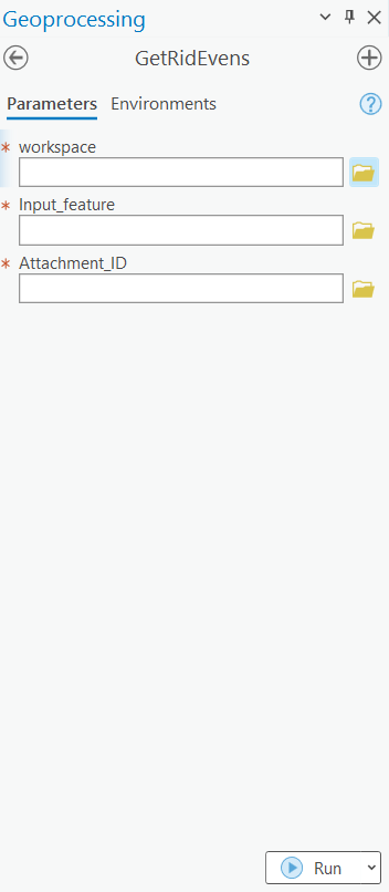

  • I only need data from the odd points. I  used the following script which  I am attaching an image of below, to get rid of all the even points. I ran this through a custom analysis too, which I am attaching an image of below.

  • My problem is in the detaching evens  section

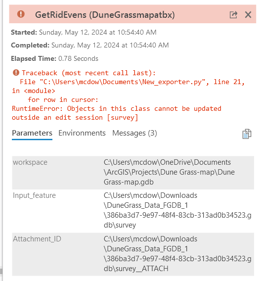

  • I keep on encountering the error message when I try to run it as an analysis tool that:
  • If anyone has any suggestion on how to solve this or a generally better approach

So one thing I see is your input workspace is using OneDrive.  I know other workflows in ArcGIS Pro using OneDrive causes issues in the GP environment.  Can you test a workflow for me?  Can the input workspace and Input_feature be on the C: drive vs. a OneDrive environment?  Do you get the same error messages?  Please advise.
NoahMcDowall
I updated it to C: Drive, and it still gave me the same error message that the data could not be updated outside an edit session
