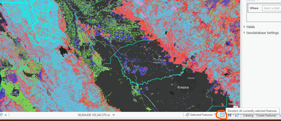

We'll be adding the clear selection button at the bottom of the map in Pro 3.1 (so that you don't have to travel to the ribbon, and possibly change to a different tab)...
For the desire to have a way to clear a selection before exporting, please see this idea and add your support by giving it kudos: https://community.esri.com/t5/arcgis-pro-ideas/de-selection-before-exporting-your-layout/idi-p/11572...

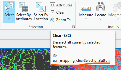

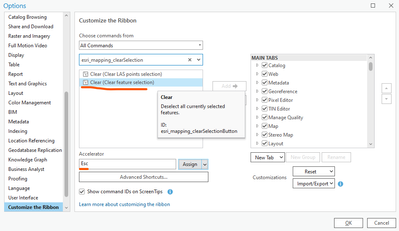

Also, you could set the Esc key as an accelerator. That command that you want is esri_mapping_clearSelectionButton.
Use that info to find the specific command and assign the Esc key:
Then you should be able to hit Esc to clear all selected features in the map.
