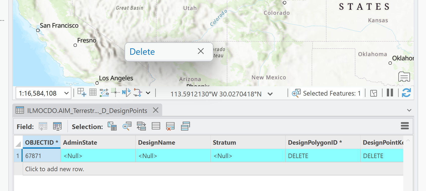

So all of a sudden the Pro delete dialog box went tiny on me.  There is no way to make it larger again.  I can tab then hit enter to get a Yes so the buttons are there just the dialog is tiny.
This is a VM so it gets reset daily but this issue stays.
Any ideas on how to get the box back to the correct size?

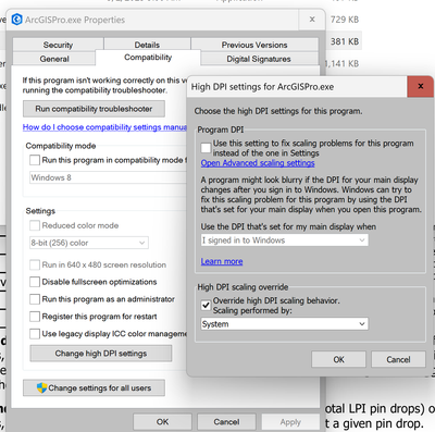

Another thing to try is
  • Open File Explorer and navigate to C:\Program Files\ArcGIS\Pro\bin
  • Right-click ArcGISPro.exe > Properties > Compatibility > Change high DPI settings
  • Check Override high DPI scaling behavior, and test System or System (Enhanced)
  • Restart Pro after each change
Perhaps this will resolve the issue you're experiencing.

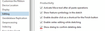

BrendanNewell
Can you try toggling the setting "show dialog to confirm deleting data", not sure if this will work but worth a try.
DougBrowning
MVP Esteemed Contributor
Thanks but did not work.  We tried everything the last few months with no luck.
DougBrowning
OMG that worked!  Its been like 6-8 months too.  The text does not look great anywhere in Pro but hey I will take it.
BTW had to use System.  The enhanced one went all weird and menus would not show.  Tried changing it back after just to test but no it goes back to tiny box.
This is on an Azure desktop.  I did already play with all the settings in the Windows app on resolution and such.  I have seen some issues with my laptop being 4K but I also tested my connected monitor running 1080 and its the same so that never worked out.
Thanks a lot!
