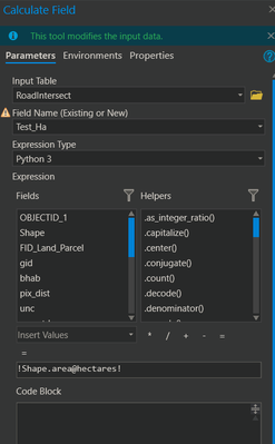

I'm using ArcGIS pro 2.7 and building a model that uses the "Calculate field" tool. I'd like the field to be a new field and it needs to be of the data type "double".
When inputting the parameters there is no option to select data type of the output field. The documentation says this is an optional parameter. However, where and how should this be entered into the dialog box?
Below is an example of what I have so far (calculating area in hectares). Currently this creates the output field as "text" data type.

The tool should then add a new dropdown of field type if its not in the table.  I hate to ask, but does the field name already exist in the table?  Also what is the error icon beside the field?
Oliver_Burdekin
Thanks David, the new dropdown is not appearing. The tool is being used in Modelbuilder and connected to an intermediate datasource. I've deleted all intermediate data and the yellow warning is to inform me that the field does not exist.
On further testing the dropdown doesn't appear when using the tool on intermediate data within Modelbuilder. It does appear if I use it on the original input feature class.

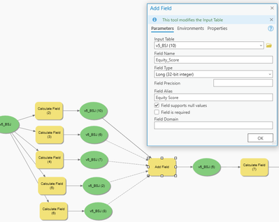

The workaround for intermediate data is to use the "add field" tool first within the model and then "calculate field"

For your distinct issue, I used Add Field so that I can be specific of the Field Name, Field Alias, and Type, before I ran the next Calculate Field.

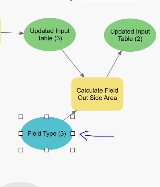

This would help to change data type in model field calculator by adding field type as parameter of your Field Calculator tool.
