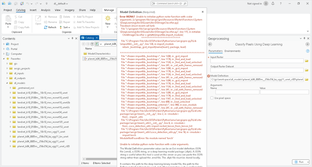

Dear Esri colleagues,
Is there a plan to release installers for the Deep Learning libraries for the recently released ArcGIS Pro v. 3.4 (i.e., on https://github.com/Esri/deep-learning-frameworks)? I am no longer able to access the Deep Learning tools after having upgraded from ArcGIS Pro v. 3.3 to 3.4 earlier today. Kindly see the error below. The model was generated using v. 3.3 and worked before.

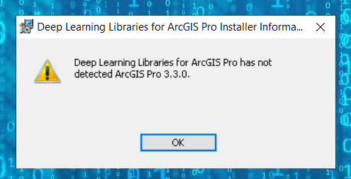

Additionally, I tried reinstalling the Deep Learning libraries (for ArcGIS Pro v. 3.3), and they apparently aren't compatible with ArcGIS Pro v. 3.4:

HollyTorpey_LSA
I don't know, but I can tell you that the release of the deep learning libraries for 3.3 came about three weeks after the release of 3.3. https://community.esri.com/t5/arcgis-pro-questions/deep-learning-libraries-for-pro-3-3/m-p/1420255
- Holly
servir_bz1
Thanks for the suggestion, Holly! (Had I known, I would likely have held off on updating to 3.4.)
AndyIngall
Hi
It looks like the files for 3.4 are available now on Github GitHub - Esri/deep-learning-frameworks: Installation support for Deep Learning Frameworks for the Ar... although not downloaded or tested yet....
