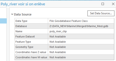

4- Open the layout pointing to this map, and the layers where I change the source, was marked with !, broken paths.
5- Close and open the layout, even the project, without changes.  Always OK in catalog but not in the layout.
6- After many tries, click ! on a layer, change the path, see datasource repairs and hop, links are now OK ! disappear and the visualization right.
7- Close and reopen the project.  Yes, the visualization of the map is right but, links are OK but, the ! have reappeared.  Check the link and they are OK.

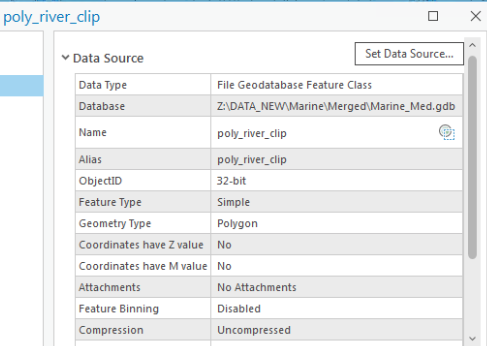

The only thing I can see is a problem with the reading in the database since the source has missing information.  Maybe the repair is problematic since when I add the same layer directly it's OK.
Layer added.
 Layer repair by Pro.
MarcelSt-Germain
Hum, weird, I close and reopen again the project and this time, the mark ! are gone and the properties ok.
