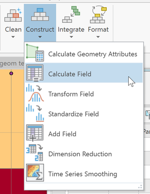

The step are quick... Data Engineering collectscurrent a new functionality into one place.  For example, to access the Calculate field to add the new one and calculate your new type, you can access it through Data Engineering through ArcToolbox

So excited to hear you are interested in the Data Engineering view! Converting a field type is something we're actively discussing internally - we think it would be really useful to streamline this process. If you'd like, you could add it as an ArcGIS Pro idea so that you can be updated if it becomes part of the software.
