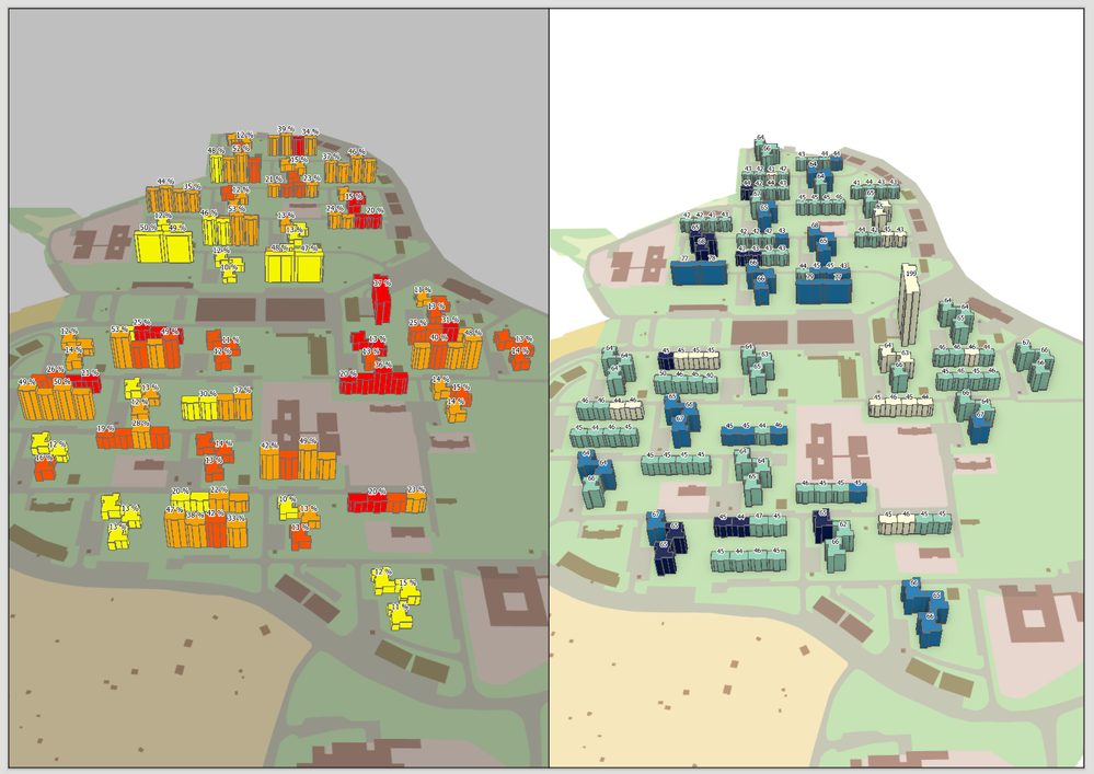

One of my 3D scenes is darker than the other one. Where could be the problem / difference in the settings? Both have enabled lighting. Just made a new Scene with exactly the same layers.Snímek obrazovky 2024-04-26 065516.png

Interesting.  Question for you - how was your first scene created? Did you use a scene layer package to create the scene?
TomášKlimeš
Thanks for responding! It was created from a 2D map and the brighter one by copying layers from the darker one. No, I did not use the scene layer package.
TomášKlimeš
It works! Thank you very much. There's a difference between creating New Local Scene and converting 2D Map to Local Scene when it comes to lighting.
