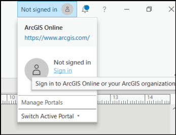

CharlottePeters95540
Hopefully, this will help troubleshoot the issue further. I was having export issues where I customized an ESRI basemap using the ArcGIS Vector Tile Style Editor but it wouldn't print or export on any maps from ArcGIS Pro v. 3.2. I fixed my issue by signing into my ESRI account within ArcGIS Pro.
L__Pie
worked for me! 👏
