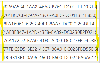

Hi,
When importing data from a PostgreSQL database into ArcGIS Pro, the UUID from PostgreSQL are transformed into GUIDs, and for some reason the GUID contains curly brackets in the begnning and end, as showend below:
Do you guys know how to avoid that? Or, how to remove the curly brackets?

The most important statement you made is, "when importing..."  I am guessing your field type in Pro will show as GUID.  If so, you can't just remove the curly brackets.  How are you importing the data?
DanielSørensen
Hi, I add data as a query layer and export features into a geodatabase, and yes, the field type in Pro are showing GUID. Maybe this field type, will always include curly brackets?
