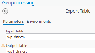

I have csv files dumped from my GPS and Pro sets all text fields to 8000 characters in width. This is a known non lethal bug. I am old school and use a schema.ini file to override this. When you open a csv file, Pro scans the field values in the first line of the csv file (below the column name header if it has one) to set the field type based on the value encountered. If the first value in the zipcode field is 123456789 then it would interpret the field type as Long (integer) whereas if the first value is 12345-6789 it would set the field type to Text as mentioned elsewhere. A schema.ini file can be used to override these setting.
An empty schema.ini file can be manually created and then edited in Notepad but can also be created *automatically and populated if one doesn’t exist. In any case the schema.ini and csv file(s) must reside in the same folder for this to work.  You can have many csv files in the folder but only one schema.ini file. The content of the schema.ini file is structured such that each csv file has its own section or none at all. In your case it might look like this wherein the first line is the csv filename in [brackets], Col2 is named zipcodes (the problematic field) and you are setting it to a Text field type of Width 20 characters:
*You can use the Export Table GP tool to export the Input csv to a new Output csv Table and its section will populate automatically in the existing schema.ini file in the target folder or a new schema.ini file will be created and populated.  This simplifies typing and editing.
The use of a schema.ini file might be useful when trying to automate a workflow.
