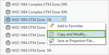

In ArcGIS Pro you can create custom projected coordinate systems using any of the supported projections. You can also modify any of the existing projected coordinate systems.
You can find more instruction and explanation in this lesson: https://learn.arcgis.com/en/projects/choose-the-right-projection/#
