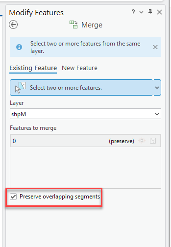

It sounds like you need to work with M-enabled features. Once you have that, you will get this option in the Merge tool (more info)
ArcMap had similar behavior for M-enabled lines.

That did the trick.  Thanks.
