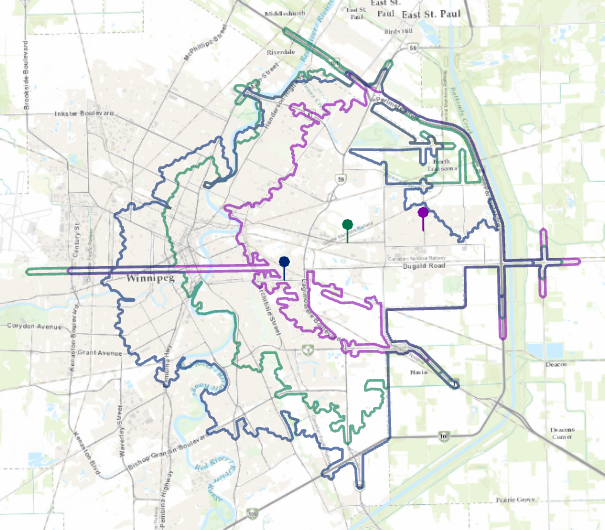

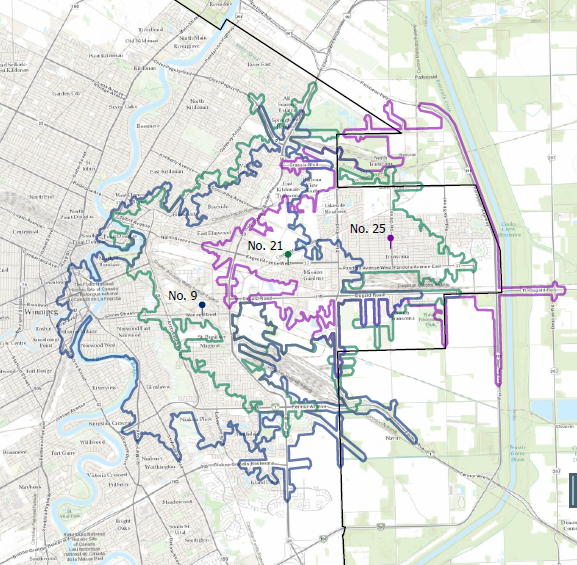

I am using Pro 3.6.0 and I am trying to build a network dataset from 2 shapefiles (existing and proposed roads) in order to perform a service area. I am missing a step somewhere or I have not done something properly. Below is what I received when running the service area with my network dataset as well as what it looks like using Esri's default network dataset.

My dataset
Esri dataset

Thank you. I did run an service analysis on both and they are not the same. The service area from the dataset is too angular so I am trying to find where I went wrong with it in the building of the network dataset.
