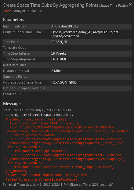

I am working the Analyzing traffic accidents in space and time case study and trying to run the Create Space time tool.
This is the error message I get:
Error message

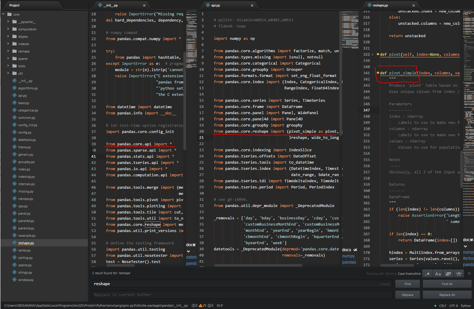

By curiosity, I followed the Traceback and I see all modules are there. Am I missing something?
modules

From a very similar Esri Support Services incident:
Please go to the ArcGIS Pro python window and type "import pandas" and see if this successfully imports. If you need help with this please let me know. Additionally, go to C:\Program Files\ArcGIS\Pro\bin\Python\envs\arcgispro-py3 and launch python.exe. In the command line type import pandas and see if this successfully imports. If it does not import than you likely have an issue with your python install and I will recommend deleting the arcgispro-py3 folder and running a repair on the software.

Thanks Robert,
After reinstalling the tool works properly.

DanPatterson_Retired
MVP Emeritus
http://desktop.arcgis.com/en/analytics/case-studies/analyzing-crashes-2-pro-workflow.htm
You are using Pro 2.0
Pandas version? to check ....
import pandas
pandas._version.get_versions()
Out[8]:
{'dirty': False,
 'error': None,
 'full-revisionid': 'e346c663cf76186c22f4d3b703461b1b60db280f',
 'version': '0.20.1'}
Or
Out[2]:
{'dirty': False,
 'error': None,
 'full-revisionid': '825876ca7ee8ac7bea463925399c083d5f190b3e',
 'version': '0.19.2'}
To test, and compare the import error line without digging through can you confirm which?
SamyBouma_Ngock1
Deactivated User
just for info version is '0.19.2'
