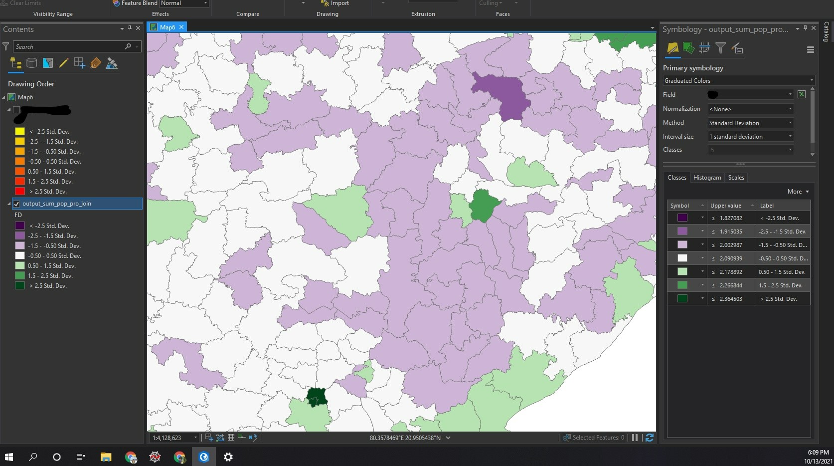

Hi all,
I used graduated colours and standard deviation for the symbology of my layer. All the field values were divided into 7 classes.
Similarly, I have the same layer with a different field. So again it's divided into seven class values in the symbology by graduated colours and standard deviation.
I want to compare the features that fall into the same class value of symbology. If I can create a field from the symbology classification then  I do the matching of the same class or rank for both the fields. Please help me to do this.
How to create a field of classes that the features belong to?

Instead of thinking about it from the symbology point of view, you could use the Reclassify Field tool to add a field - it has a Standard Deviation reclassification method so it sounds like it will allow you to do what you want.
Hope that helps.

saidurgamalleswarthota
Thank you for helping. It worked as I wanted.
