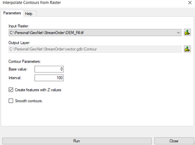

You may download ET Surface, and use Raster Surface Analysis > Contours from Raster tool. I downloaded the latest version (ET Surface 7.1).
After its installation, open ETSurface 7.1
Open the output contour Feature Class in ArcMap/ ArcGIS Pro.
