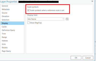

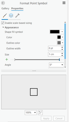

@IB3 these are the steps:
1. Change your 2D symbol units to cm in Pro options
2. Set your point symbol to be a rectangle 1cm in size
3. Set a reference scale on your map of 1:100 scale
4. Set your layer to scale symbol when a refernce scale is set
Hey presto, you have a 1m square.
Obviously this also applies to any symbol. You can import your own SVG symbol instead.

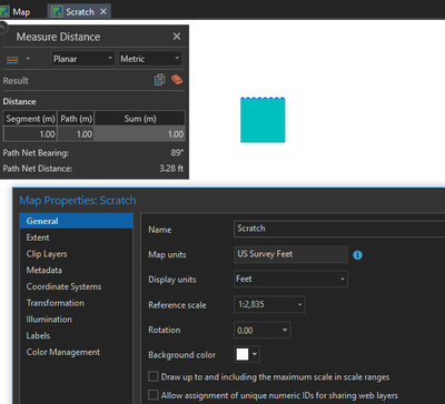

jcarlson
MVP Alum
Also useful: https://www.convertunits.com/from/meter/to/pt
Points don't divide nicely into metric units, but when you know the conversion, it's possible to set the reference scale such that 1 pt = 1 m. Where 1 m is roughly 2835 pts, a 1 pt symbol measures out to 1 m.
