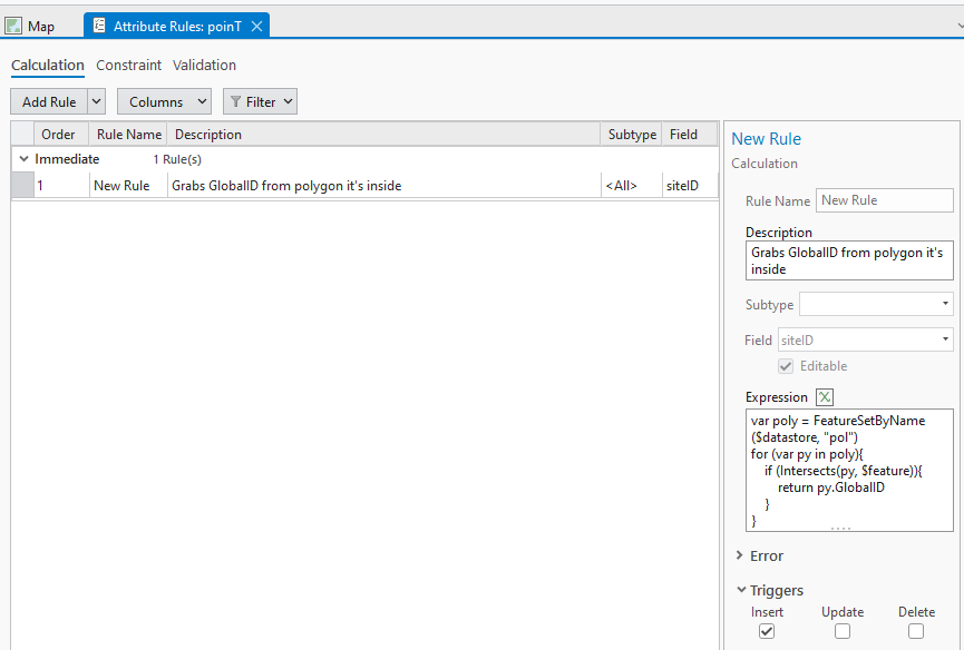

Try using an attribute rule. (Also you should probably use a relationship class if you aren't already.)

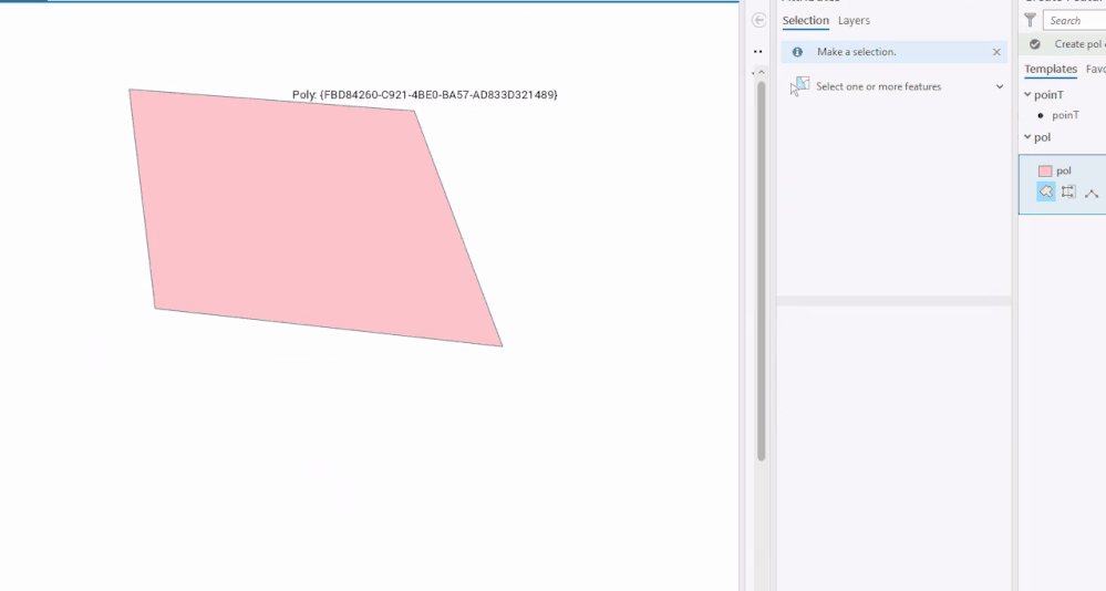

I did not make a relationship class for this example, but here's my code:
var poly = FeatureSetByName($datastore, "pol")
for (var py in poly){
    if (Intersects(py, $feature)){
        return py.GlobalID
I wrote this with the idea that the polygons don't intersect and that each point can only be in one polygon. If this is not the case, then it'd be more complicated.

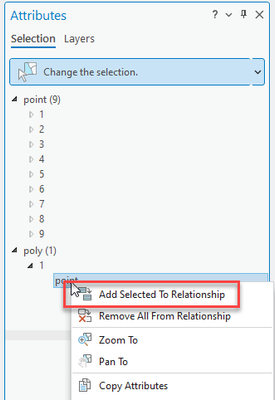

@HannahLegacy
Are you using the Attributes pane? You should be able to use the "Add Selected To Relationship" command if you select the points and the polygon. Like this:
ref: https://pro.arcgis.com/en/pro-app/latest/help/editing/edit-feature-relationships.htm
