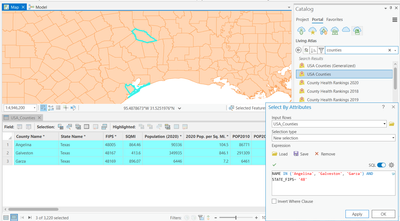

Don't use <> operator for text. Instead use = for single value and IN for multiple values. Also use AND gate for both the arguments to be true. An example is given below (I used County boundaries layer available in Living Atlas).
NAME IN ('Angelina', 'Galveston', 'Garza') AND STATE_FIPS= '48'
