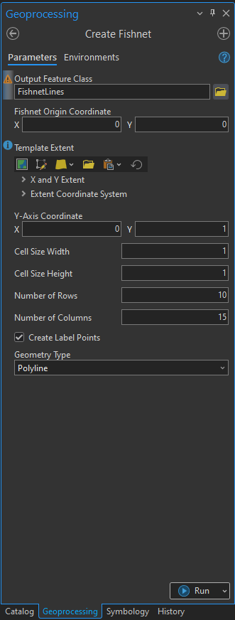

I created a fishnet in ArcGIS Pro using the parameters shown in Screenshot 1.

First up, just in case...you have to actually replace the r"Path_to_Fishnet" with an output path of where you want to create the file. Either using a variable that you define elsewhere or pasting an explicit filepath in between the speech marks.
Secondly, if you look at the sample script for this tool (on the help page) then the format for both the origin coordinate and y axis coordinate is a point (not a number). So the tool is expecting a string separated by a space. I believe the input (based on your toolbox inputs) should look as below:
