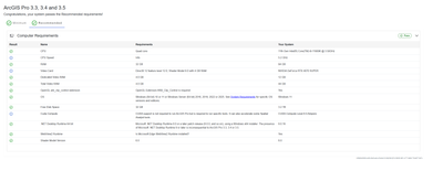

DavidLeggett
took 1 for the team..
ChrisUnderwood
OK, thanks. And does that reveal any pattern to those who do/don't see the problem. For example, does it only occur with Windows 11, or only with .NET 8.0.16 ?
If there is no apparent pattern, this thread would still benefit from a more prescriptive set of steps to reproduce the problem. For example, Layouts seem to be mentioned a few times, are they essential to initiating the problem ?
