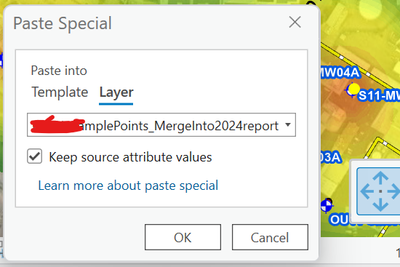

DrewCover
Copy/Paste features between feature layers still works like in ArcMap.  I think you have to copy by R-clicking the selected feature on the map (not copy button from table), then Paste Special - Paste into Layer, and you'll have the option to keep source attribute values
