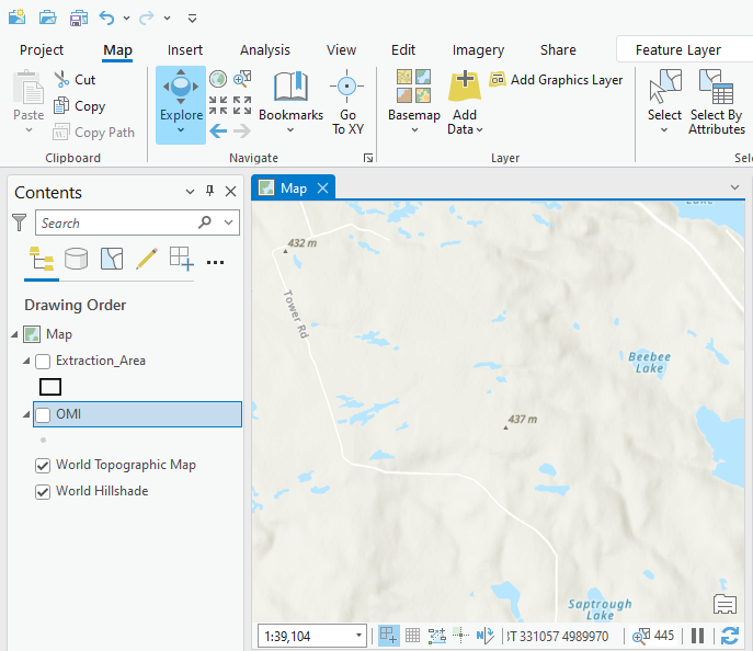

In ArcGIS Pro, I want to copy the coordinates of my mouse pointer's current position to the clipboard.
In the past, I've used the Explore/Identify tool to identify on a feature. In the Identify window, the coordinates are listed and can be copied.
But in this case, I don't have any features to identify on. And identifying on the map/basemap, in a spot that doesn't have any features, doesn't seem to do anything. The identify window doesn't come up.
I'm aware that the coordinates are displayed at the bottom of the map. But they change as the mouse pointer is moved, so that means I can't get the coordinates at a specific position in the map.
How can I get/copy the coordinates of the mouse pointer position -- without identifying on a feature?

right-click copy, right-click past
