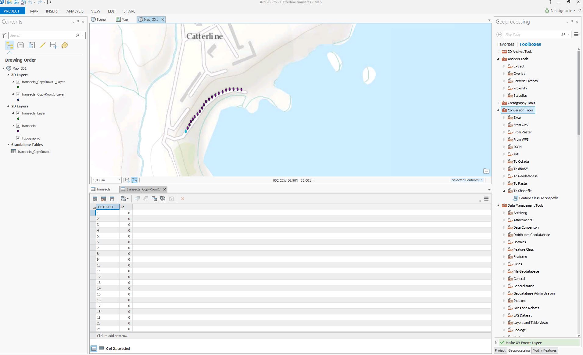

Hello,
I am a complete rookie at ARCGIS v10. I am a student using the software to try and export slope data from GIS data I have been given. I have manged to add this through the "add data" tool and the id points have came up on my screen. Using the Toolboxes>conversion option I had hoped to find a export to cad option, however there isnt one. Would appreciate any help!
Thanks,

The toolset for converting features to CAD is not yet available in ArcGIS Pro. Check the list of geoprocessing tools not available currently in ArcGIS Pro.
Tools that are not available in ArcGIS Pro—Appendices | ArcGIS for Desktop
If you have ArcMap (ArcGIS for Desktop), you could do the desired conversion.
Export To CAD—Help | ArcGIS for Desktop
