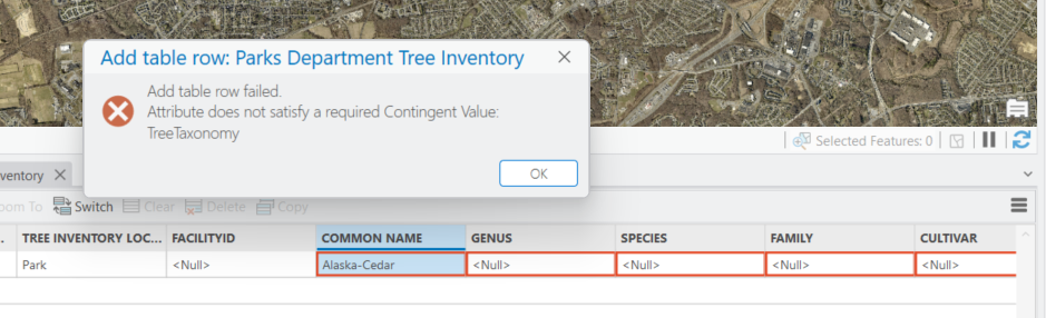

I have created coded value domains for each field, assigned them to their respective field, created contingent_values and field_groups.csv files, and ran the Import Contingent Values GP tool successfully.  I jump into the attribute table directly and click in common name and select the common name for the tree I want to add to the inventory.  I was expecting to see the remaining fields populate with the corresponding values automatically.  I end up clicking on each field, searching each list for the correct values (using the original roster.csv as reference), and selecting the values.  When I get to Family there is one correct choice visible.  If I stop anywhere along the way, this error pops-up.  I also see the same error when I try to the Create Features tool and select the feature class.

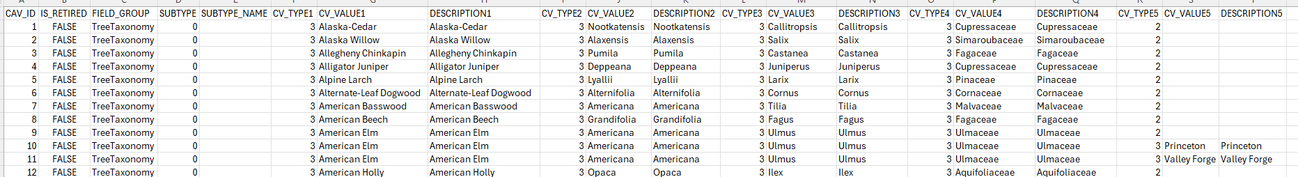

Field_Groups.csv
Contingent_Values.csv - value1 is common name, value2 is species, value3 is genus, value4 is family.

Each Attribute table has an option to auto update when there is only one possible option.  It is accessed from the burger button at the top right of the table.  The option is per table and is honored when modifying values in the Attribute table and in the Attributes pane.
The error is showing because the Contingent Attribute Value Field Group is marked as restrictive.  A couple options to avoid this:
1.  Change the Contingent Attribute Value Field Group schema from Restrictive to optional
2.  Edit required Contingent Attribute Values in the Attributes pane with the Auto-Apply option unchecked- for existing features.
3.  Use the Create Features active template pane to set attributes before creating features

JayHodny
Hi Jennifer,
Many thanks for the reply and the help.  I may have misinterpreted the "Restrictive" setting initially, so I unchecked that option.  Now the Create Attribute pane is showing subsequent taxonomy choices based on the 'common name' I select.  Next, I clicked on the 'Contingency Values....Auto-update other fields.'  When I create a tree feature using the Create Features pane, I choose the common name, and woohoo, the subsequent taxonomy values populate!  I hope that when I publish the layer to an ArcGIS Online editable service this functionality is available in the service layer in my web map in Field Maps.  Time to find out!
