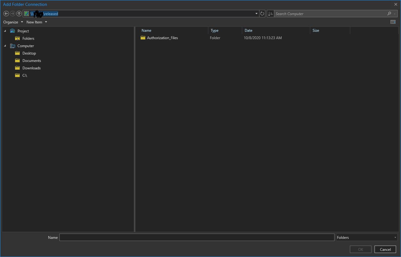

You can do this in AGP.  For example, in the Catalog Pane, I click Folders->Add Connection Folder.  At the top of the Add Folder Connection pane, you type in \\WC-ESRI\Shared\GIS and connect to the folder.  I'd probably type \\WC-ESRI\Shared\ and then single click GIS.  Then click OK.  Your URL UNC path is added as a folder connection in AGP.

You can drag and drop folder connections as well.  This is an old .gif but I just tried from a unc path and works great...
