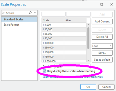

Lastly - you can lock the scales useable in a map. Edit the list and tick 'Only display these scales when zooming'

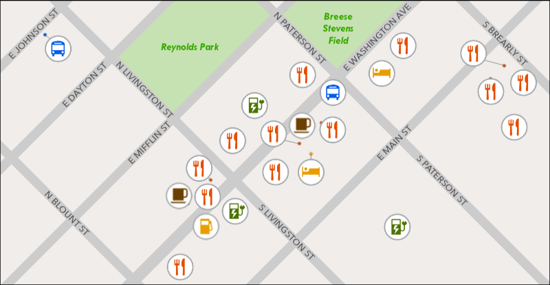

If you want to use the Maplex label conflict resolution settings to separate symbols, you don't necessarily need to put the symbols into a font. Create a new label class for each symbol using the Create Label Classes From Symbology tool. Then add a Point symbol callout in each label class point symbol which can be any graphic you construct in Pro, and you can also add a leader line.
Change the symbology to be small points that will be covered by the larger point symbol callout labels.
Configure the labeling settings to use Best position and set the zones so the center position is zone 1 with the highest priority.
Some other label settings to adjust:
  • Remove ambiguous labels: Do not remove
  • Remove duplicate labels: Do not remove
  • Label buffer: 0%
  • Preferred offset: 0 Points
  • Maximum offset: 50 Points or whatever you think looks good - if you add leader lines to your symbols you can allow for a large maximum offset and let the leader lines point back to the smaller symbology point.
  • Configure the label expression to one that will fit inside the callout symbols such as a single dash and remove the text color.
You can end up with this style - when the points have room they will label on top of the true location, but when there is a cluster and it doesn't fit it will place offset from the true location.
