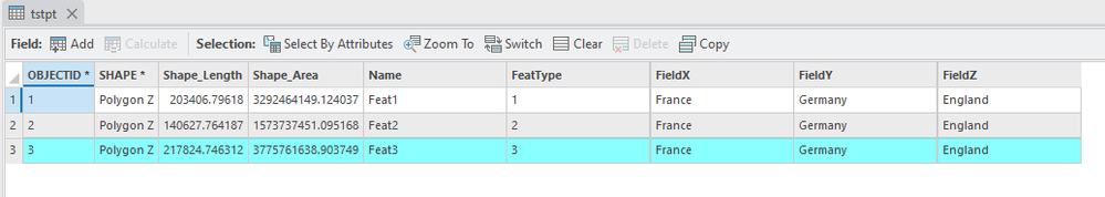

3 features with the same attributes except for FeatType

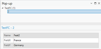

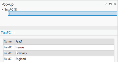

samshrma998
Hi @AlfredBaldenweck , Thanks for suggestions!!
While the expression you provided meets our requirement but it loses the look and feel ArcGIS pro provides.
We were able to write an expression which worked for us while retaining the original feel of pro map. Here is expression we used and results.
samshrma998
