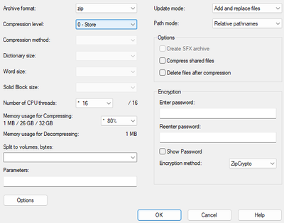

@NathanMellor I know it has been 8 years since your post but this was something we were looking to do. In the end we wanted to package fonts and fix the problems with map extent. Pro does not do this consistently or provide any information what is NOT going out to cache or how to set the extent.
Luckily we stumbled across settings which will repackage and those are to use zip format but without the compression (level 0). It looks like this in 7-zip. So far this is working great in 11.5 !
