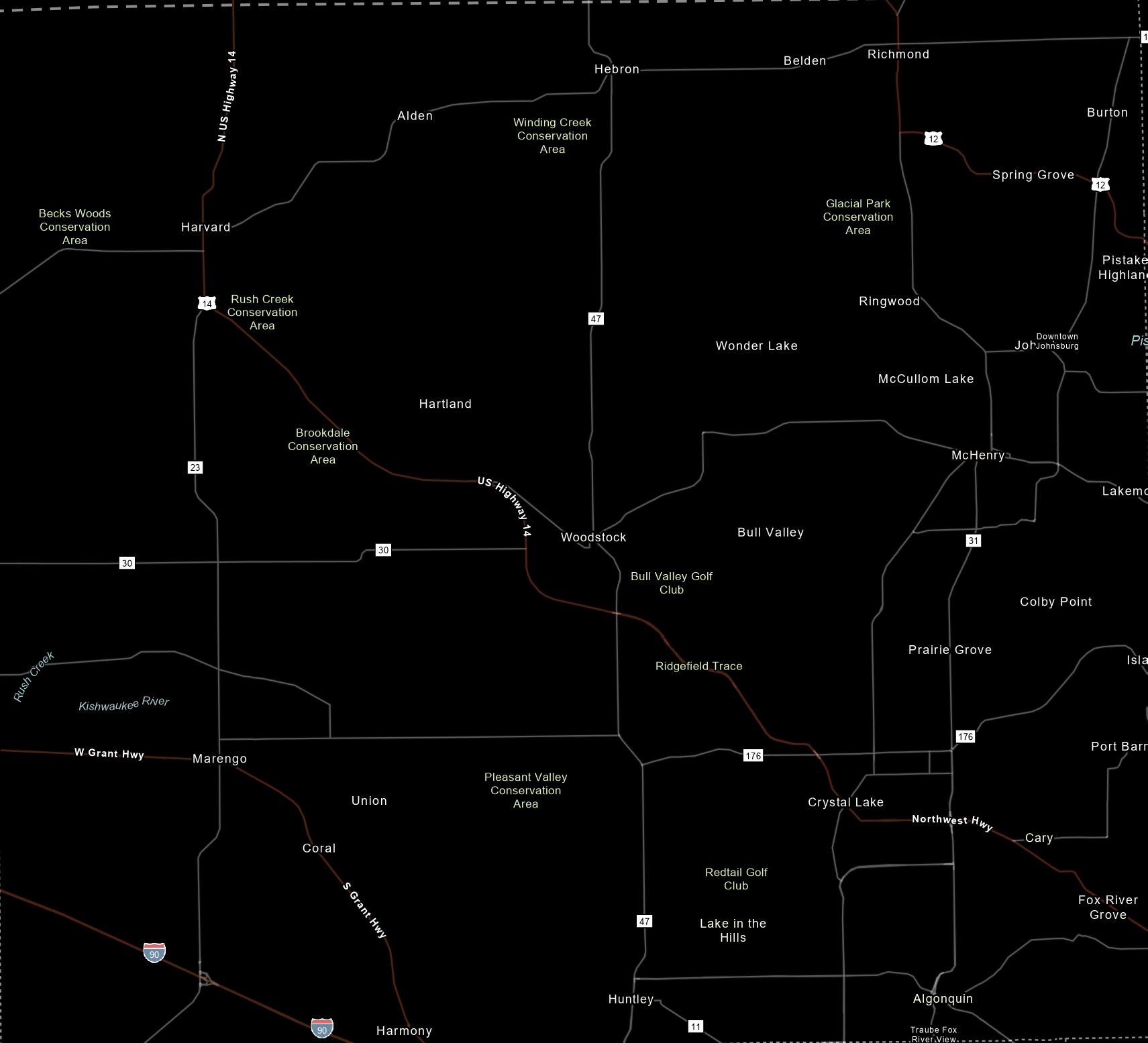

So in Pro 3.5.3, i have been trying to create composite band raster in GeoTIFF format. So, I used 5 rasters as input rasters all in GeoTIFF format. Please note that none of them are RGB or spectral bands. The output comes out black for some strange reason even though the pixels have values. I even tried rebuilding the pyramids but still the same black render on the map.

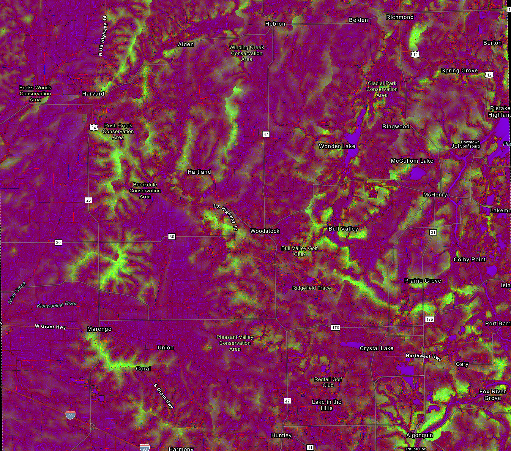

So, then, i extracted the input rasters in ESRI grid format to a geodatabase. and then ran the composite bands tool, and stored its output in the ESRI grid format as well  in geodatabase, then the output default output symbology comes out as expected.
Is the black render output a bug in Pro 3.5.3 with the GeoTIFF format output in the Composite Bands tool? Or is this a limitation when composite band output is stored as a GeoTIFF raster?
