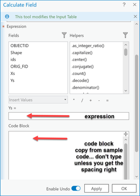

Code block, python parser.
Expression :  match(!SiteAddress!, !PostalAddress!)

GreggWolin
1. Where does the "Expression" go?
2. The table has a bunch of fields (I just included 2 for the illustration). Do i use the column# of the "visible" fields or of "all" fields?

Calculate Field Python examples—ArcGIS Pro | Documentation
Well the code won't work, It would get real ugly fast if you want to slice and compare multiple values from multiple slices in multiple fields to slices from one input field
As I said earlier, it would be easier if you added a new field and concatenated the values from the fields you want to replicate the full address.  Then, you can compare the two fields directly
