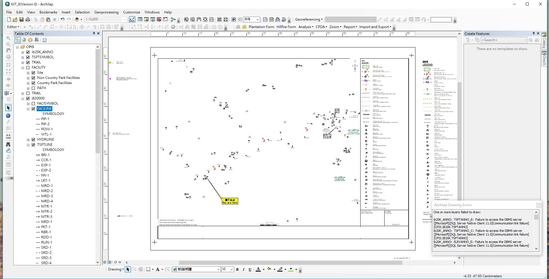

I have setup a geodatabase on SQL Server 2014 and then installed ArcMap 10.4.1 on a client PC. The ArcMap can open the feature classes and tables on SQL Server, but once the PC screen is locked, after unlock, the ArcMap prompts communication link error but the connection between PC and SQL Server is normal. Anyone have ideas?

Thanks for your help. I have just figured out what happened.
On Win 10, TCP chimney is disabled by default. SQL Server connection often loses after the PC is idle for certain period of time and TCP chimney is disabled. The problem is resolved after TCP chimney is enabled on client PC.
