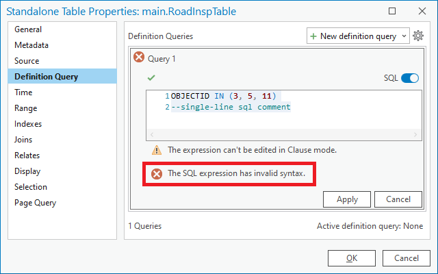

I want to put SQL comments in definition query SQL expressions. From my testing, these kinds of comments seem to work as expected:
Works: Multi-line SQL comments at the beginning or end of the SQL expression:
/*multi-line sql comment*/
OBJECTID IN (3, 5, 11)
Works: Single-line SQL comments at the beginning of the SQL expression:
--single-line sql comment
Doesn't work: Single-line SQL comments at the end of the SQL expression:
Error: The SQL expression has invalid syntax.
Question:
Why don't single-line comments work at the end of SQL expressions in ArcGIS Pro? Is that a bug?

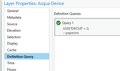

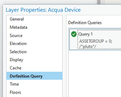

gpgisandsky
Hi Bud,
you have to complete the sql string with ";" then write your comment like these examples:
It's works on Pro 3.1.4. thank you

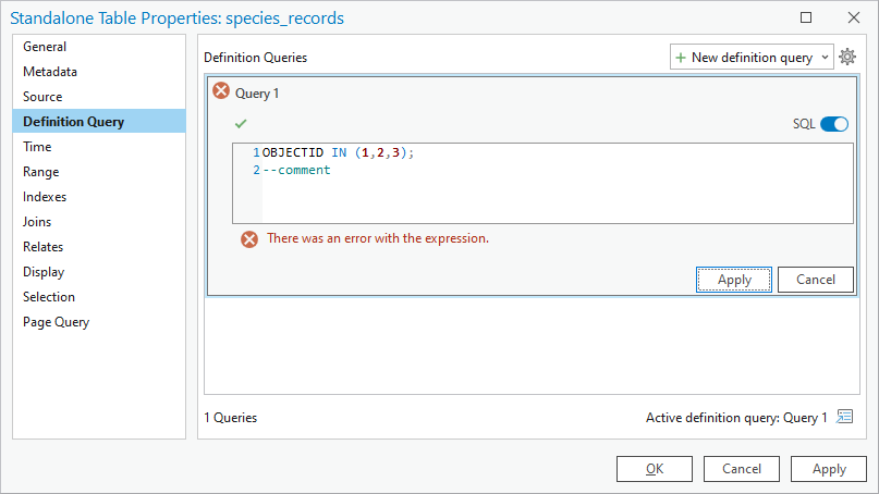

Bud
Legendary Contributor
Definition queries are the main use case. I just happened to test in Select By Attributes because I thought it would behave the same way.
I couldn't get a semicolon to work in a definition query in ArcGIS Pro 3.2.1 / mobile geodatabase:
There was an error with the expression.

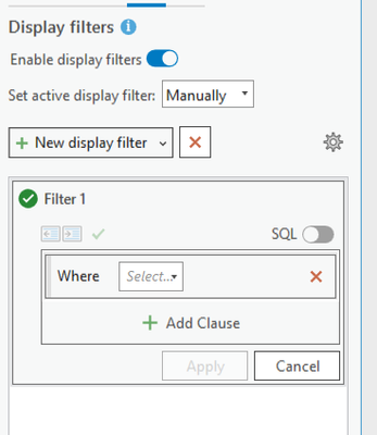

What do you mean by "query filter"?

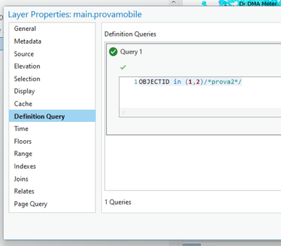

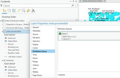

gpgisandsky
Hi Bud, for mobile geodatabase don't put semicolon but try to put only this kind of comment at the end of line or at new line: /*pippo*/ likes :
it's works on my ArcGIS 3.1.x and mobile geodatabse. This confirm that ArcGIS work in different way on different format (file, personal gdb ...) too.
About "What do you mean by "query filter"?" I would say query filter in "display filter"
