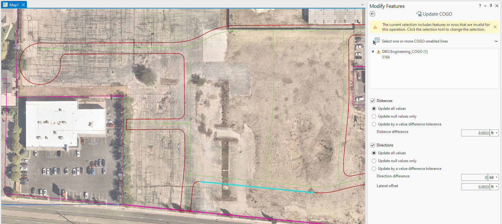

I tried using the "Update COGO" tool from the Modify Features pane, but when I select a feature, a warning message pops up saying, "The current selection includes features or rows that are invalid for this operation. Click the selection tool to change the selection."

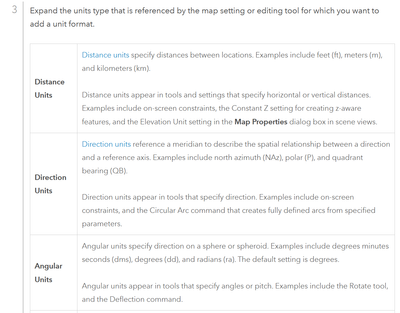

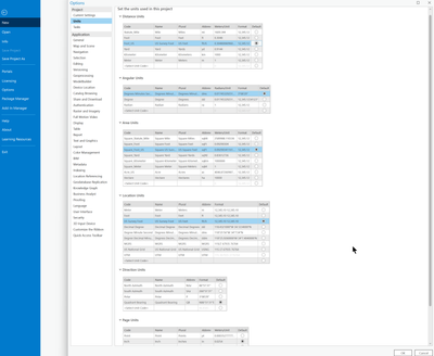

does your Pro > Options look something like this?
BillFox
MVP Notable Contributor
BillFox

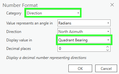

Second, I went into the ArcPro Options and set all the Units defaults to the ones shown in your screenshot, but that still didn't fix the display in the Attributes pane. What I ended up finding was a solution from this post, https://community.esri.com/t5/arcgis-pro-questions/update-cogo-attributes-in-pro-2-4/m-p/401406#M178..., which describes changing the Number Format from the Fields View for the COGO-enabled layer. "Pro" tip: you have to double-click the cell to get the options icon (...) to appear.
That post provides good details, but the gist of it is that for each field, you can set the number format (including the number of decimal places), which for COGO direction requires changing the category to "Direction" and the display value to "Quadrant Bearing" (I set the decimal places to zero because it's rare to see a plat with the seconds more precise than just whole numbers).

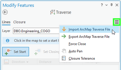

As I said, I was really hoping this would work out, because I do prefer the ArcPro traverse tool over the ArcMap one, and this has officially sold me on it. Additionally, the "Import ArcMap Traverse File" option works well for adding descriptions (.txt files) that were generated using the ArcMap traverse tool.
