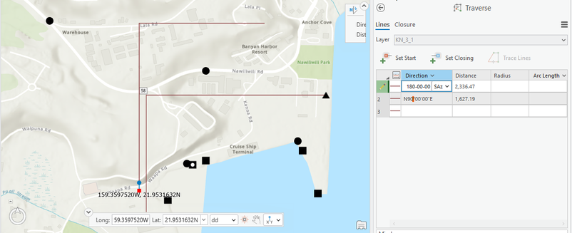

6) My next step is to open Modify under Edit and select Traverse. I set the start point on the NAWILIWILI control point as seen in the red dot on the triangle below. I enter SAz, 0-0-0, distance 2,336.47'. I then enter  SAz, 90-0-0, 1,627.19'.
This is where it gets off. These two survey points should set the POB for the easement. The problem is the POB is in the ocean and not where it should be:
Where it should be is somewhere near this circle:
I'd really appreciate it if somebody could give me a step-by-step on how to do this. Thank again.

Yep, I think you are right. Here is what I get when I input 180-0-0 SAz 2336.47 and 270-0-0 SAz 1627.19 from the pin as the Set Start point:
You can see it is way above and to the left of the marker.  Even when I go the other way it gets close bit still off. I believe it was shot wrong. Thanks again!
