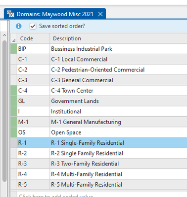

I've created Coded Values in a Domain, for Parcels, to enumerate 10+ Zoning Categories.  The Codes and their Descriptions have been created.

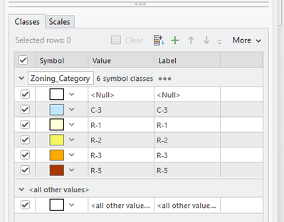

When I right click the Parcel layer in the ToC > Symbology > Primary Symbology: I choose Unique Values.  I set Field 1 to Zoning_Category. On the Classes tab, I hit the Add All Values icon.  Here's the problem: The Symbol only displays 6 symbols, even though there are 11 coded values available.
I DID click/check  More > Include all other values, but the other classes do not get added to the Classes
How do I make both the Symbol column (Classes tab) and the Table of Contents to display all 11 classes?

As my screenshot shows above, The Table of Contents and Symbology ARE displaying various rows for different coded values, just not all of them. I can't imagine the software would limit the number of coded values it's able to symbolize - to just 6 different value s.  It seems random that it would show some, but not all.
Hoping  there's a way to show all coded value classes...

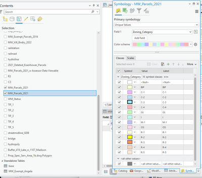

@Brian_McLeer , That  helped!  I added values to the features, one for each coded value, for multiple parcels.  That resulted in a class being created for each coded value, per the screenshot below.  One remaining challenge though:  the Table of Contents did not display any of the various enumerated classes.  The screenshot shows this also.  Thoughts about how to make the classes display in the ToC?

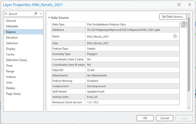

@Brian_McLeer , poking around looking for what might be causing the problem, I see that my Parcel FC is listed as being 32-bit.  Is that OK?  (Wondering if that's contributing to the problem).  The GDB that the FC resides in ( Maywood Misc 2021.gdb) was created in Desktop a few years back.  Did I need to do a conversion of any sort to make that GDB work properly in the 64-bit ArcGIS Pro era?
See screenshot below:

@DaveMartin1 hard to say, I have not encountered this one so I don't know if there is anything to convert. You could test by creating a new GDB in Pro, then do a feature class to feature class GP tool, then point your zoning layer at the new testing feature class in new GDB and see if that fixes it. To my knowledge, ArcGIS Pro should support FGDB from ArcMap.
