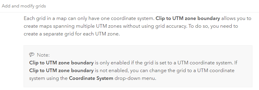

Hello,
 Is it possible to clip a map based on a grid? I want to specify one UTM zone and clip the region, but I can't figure out how to either convert the grid to a feature layer to apply a clip or clip the map extent inside the zone.
I believe ArcMap has a similar tool, but I'm not sure if Pro does.
Thanks,
Jonah
