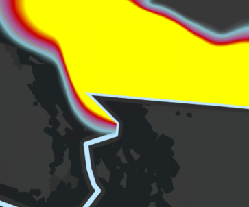

If you're rendering the map in Pro, you can go to the Map's properties and fiddle with the Clip Layers section. This'll create a clip mask that you can apply to layers, including the output of the Heat Map symbology. Here's an example of what this looks like from a layout I made:
