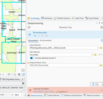

I've tried multiple attempts to clip this feature, using different clipping tools, and all of them come back with the message ERROR 000210: Cannot create output. This problem exists with other layers I have.

ThomasGoodridge
Solved, turns out the place it saves to by default didn't exist, so I picked a new place
