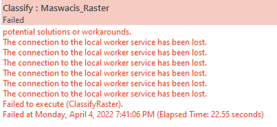

I am currently trying to use the Image Classification Wizard on a mosaic-ed raster, but any attempts to do so result in the error below:
There were no saved error logs in my AppData folder either, so I have no greater detail than that. Any help would be appreciated!
