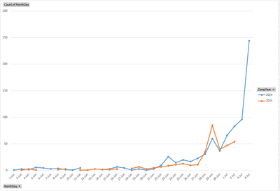

Thanks for pointing out the data clock, I'll take a look at that, seem to have missed it when I was poking around. I used python to calculate the day/month (3-July for instance) as a text field from the time stamp and the year as a separate text field also. My pivot chart looks like this but the data clock might be a better visualization.
