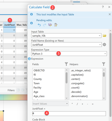

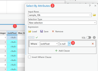

Thank you, do you know a similar process for a field where there are some numerical values? that looks like it would work for a field where every value is null
DanPatterson
MVP Esteemed Contributor
If you checked, you would see that the first image just selects the null records.
In the second image, only the "selected" records will be converted to 0,
That is standard in all Pro tools.... only selected records are acted upon
