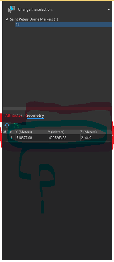

I have a question about the Layer Template that I have created in ArcGIS Pro.
My question is how do I change the geometry for Latitude and Longtiude to be able to display it ?
Here is an example of what I am talking about Showing Geometry in Attributes
See that red circile I have drew around it but what I am talking about the Geometry and they are in UTM Meters...
How do I change it to DD ?
Is that possible ?

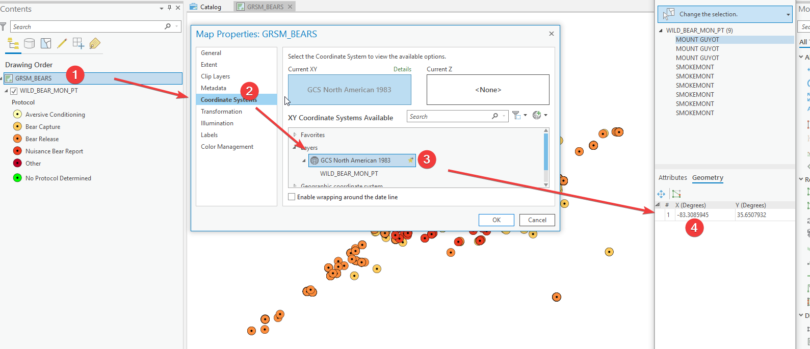

I looked it around carefully and wasnt sure if I should change it like you showed me in # 2, so I posted this question...
