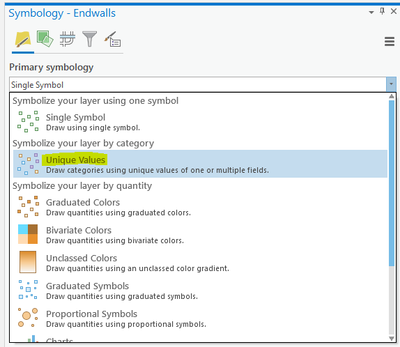

If you go into the Symbology settings for the layer, you can change the symbology settings from Single Symbol to Unique Values. You can then assign a unique symbol to each value of station name for example.
KimberlyGarbade

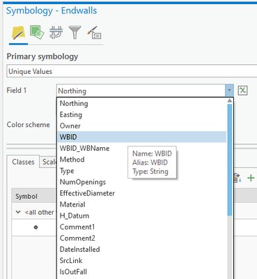

If you converted  the CSV to a feature class you can double click your feature class' symbology in your table of contents.  This will open the Symbology Pane.
Symbolize on "Unique Value":
Then you can pick the field that contains the unique values you want to symbolize based upon.
KimberlyGarbade
