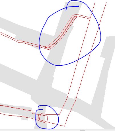

Hi, everyone,
please, I have a little polyline that comes from a polygon (someone converted a polygon into a polyline). I want to turn a polygon back!
How can I do that? I try to use the polygon feature, but the result is not good.

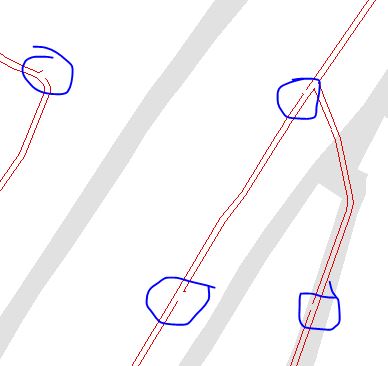

The ultimate goal is to create a shp with a center line, without all the breaks. So I thought I'd convert it back to a polygon and then a center line. But I'm not being able to re-transform into a polygon.
When someone did the conversion, they created a polyline with many interrupted segments, image below.
THANKS A  LOT!

Hello:
I do not know if this totally answers your question. However, I have used the Generate Edgematch Links tool to help me find centerline segments that look like they should be connected, but are disjointed. I have then used the Edgematch Features tool to help connect some of these disjointed centerlines. I hope this helps you out.
Nico
thainamota
Hi Nico
thanks a lot for your advice... I used it for another case
in this case i did manually because the disjointed segments are in the same feature.
Thai
