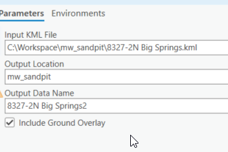

Came across this same issue today. I needed to trace gpx tracks as they were a mixed bag of incomplete tracks.
I resolved it be re-importing the kml - but ensuring that I had the 'Include Ground Overlay' checkbox ticked. This then allowed me to trace the kml features
